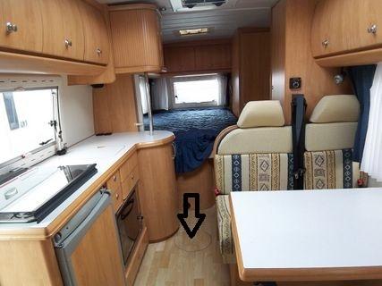

  • Hi bpatkiel,
    in the floor, opposite of the entrance is a small cover. Lift it up and you see the handhole cover of the tank, which you can open by turning it anticlockwise.
    The eletrodes for the tank are fixed on the cover.
    Does it Show always "empty", or always "full" (or somewhat inbetween)?
